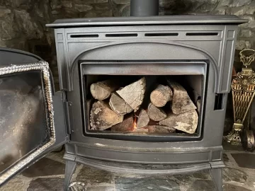

I just lit both of my Ashford 30's, as it's rainy and chilly today, and decided to run an experiment based on this conversation. One of these stoves is located in a small addition to our house (i.e. ~1200 sq.ft.), and was stuffed nearly full with medium oak splits + a few smaller maple branches which look like maple. Although I really need very little heat in this small, newer, and well-insulated addition, I decided to do a full load, just to see how a ~30 hour burn might do with it.

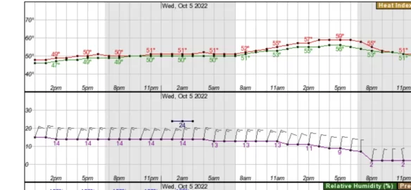

Outside temperature forecast is 45F climbing to about 57F over next 24 hours, with a good breeze:
[Hearth.com] sorry .... another "pls help me pick my perfect wood stove "
Stove about 75-80% full of wood:

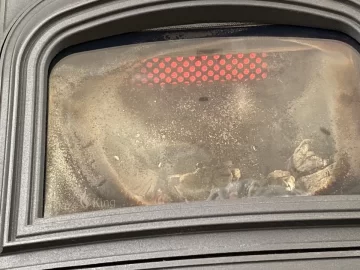

Turned way down to "black box" mode, with 4-year old cat still doing fine:
[Hearth.com] sorry .... another "pls help me pick my perfect wood stove " [Hearth.com] sorry .... another "pls help me pick my perfect wood stove "
We will see what happens with the indoor temps, I'll try to post back this evening and tomorrow. With the warm weather and very low burn setting, I may stall this very well-used combustor, we shall see. Turn-down ability is always limited by draft (i.e. outside temperature) and combustor age/condition.

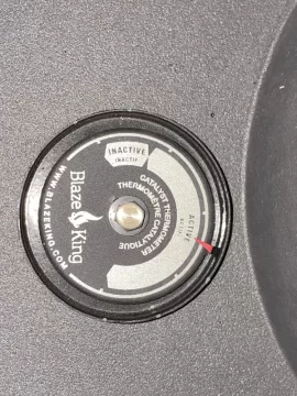

Follow-up to post #11: 6 hours in, addition is up from 68F to 73F and steady. Cat is holding in low active region (~600F), and single wall stove pipe is holding 150F external.
I'm going to move the results over to the all things BK thread in the morning, since it sounds like OP is leaning more toward Neo or T5 anyway. But just to close things out here, a quick status update:
10 hours in, that side of the house is holding 72F and steady and about 1/3 of the wood load is consumed... right on target for 30 hours bur time (esp. considering it wasn't a full load to start). Single wall pipe is around 130F, and cat is just at edge of active/inactive, indicating likely stall if I don't increase air. Warm day on a short chimney means poor draft, and my cat is in it's fifth season, so I was likely pushing things a bit.
