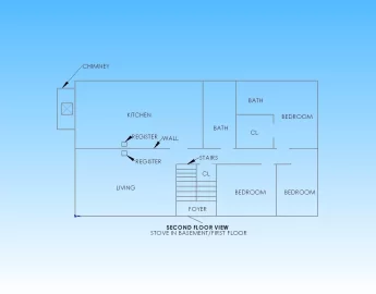

have a split foyer house and stove on one end. put 2 12 x 12 registers in. 1 in the kitchen and 1 in the living room. works great. one acts like a cold air return. the air moves in a circular motion. if that makes sense. if i close one off it doesn't work as well. with both open it works great. try that.
Thanks Crabby. Let me see if I understand. You have a 2 story, bi-level house with the stove on the 1st level on 1 side of the house. You cut a 12x12 hole in your floor above the stove area to either the living room or kitchen to allow for the hot air to rise to that room. You then created a 12x12 hole between the floors on the other side of the house that allows for cooler air from the other room on the 2nd level (either the kitchen or living room) to descend to the side of your house opposite your stove. Is this right?

quote author="Eric H." date="1288763428"]Thanks Crabby. Let me see if I understand. You have a 2 story, bi-level house with the stove on the 1st level on 1 side of the house. You cut a 12x12 hole in your floor above the stove area to either the living room or kitchen to allow for the hot air to rise to that room. You then created a 12x12 hole between the floors on the other side of the house that allows for cooler air from the other room on the 2nd level (either the kitchen or living room) to descend to the side of your house opposite your stove. Is this right?
Thanks!
Eric[/quote
i drew something up for you to look at. i know what i typed out didn't make a whole lot of sense. sorry.

Thank you! Do you find that the bedrooms get enough warmth from the air flow? Also, the layout of my house is almost the same as your's only my fp is on the other side of the house below the corner bedroom. If I were to do this I'd probably have to put a register in the floor of all three of my bedrooms. This would all be much easier if I could see air.
My garage is under my bedrooms so yeah it's a little chilly in the rooms, but i have baseboard heat. so it all equals out pretty good. i usually can't burn until the temps get into the 30 and stays there all day lone. it's been geting that cold at night, but during the day it's about 50. if i were to run the stove it would run you out of the house. oh yeah i forgot to mention too. a friend of mine put a register in his floor witha small electric fan in his it works great. you could use a booster fan they put in round duct work too. you get them at lowes or home depot. just a few more ideas. you can put them on a switch to control the speeds as well. also try not to put a vent to close to the stove or above to stove. one reason it's not code i guess and a fire hazard ( i know a lot of folks do it anyway). plus if there is one right above it all the heat goes up that register and not the others and the one room will be so freakin hot and the stove area won't be as warm either. got to kinda equal it out.
