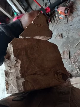

2nd year with wood. Finally getting about a year ahead on my stacks so I'm starting to experiment with split size. Used to split really big so I could process maximum amount of wood to get ahead. Also thought bigger split would burn longer and give off more heat overall. Here recently been splitting alot smaller. The pic is average up till now split size and how I've been splitting recently. What a difference burning small splits makes in my stove performance wise. My stove top temps gain around 150f using same wood just different size. House is about 5 to 8f warmer. Have lost a little burn time though. Think I will be going back and resplitting alot of this year's wood down smaller. What do you guys think?

I find the opposite to be true and split on the large side...2nd year burning for you? Your wood has had a extra year to season and is responsible for your higher temps is my guess..
I tend to split small, my stove top loads and it's easier to laod smaller splits and get it full or at least top off the load. I have been splitting larger lately to get a good mix. Small splits do seem to give me higher heat faster. in the long burn I think it all evens out. Might get a little more time between loads with some larger splits. On an old simple stove we always liked big splits for overnight, but most like green wood for that too.
I split all 3. Large, medium, small, because Ill.need all 3. Smalls and medium will give off more heat because there is more surface area to catch and burn. I use small and medium to get the stove up to temp. The larger ones definitely for overnight and long burns. I put a bunch of bigs in the stove last night at 8pm.. its 6.30am and stoves still going at 400 degrees
Smaller splits will have more surface area to burn and therefore put out more heat but also shorter burn times The larger splits have less surface area hence why they are better for overnight burns. They won’t burn as hot but they will burn longer.
Always best to have a variety of size splits depending on the time of day and what temps are outside.
