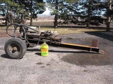

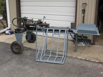

Here are pics of a back breaker before and after an upgrade.
I remember when you did that work on Shari's splitter....nice job.

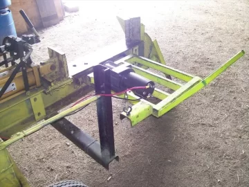

Another example of an electric lift (mine):

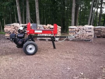

I saw somebody on here who put their splitter up on a set of car ramps like these and then rested the tongue on a large round. That seemed like a good idea.

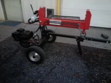

I've looked at super split but all the wood I'm going to get is big and knotty. How did you raise your HF 4"?
I welded 2 peices of 4x4 angle together to make 4x4 sq tube and used that under the front. I fabbed a piece for the rear out of 1/4'' plate.
Before
[Hearth.com] Splitter Height
After

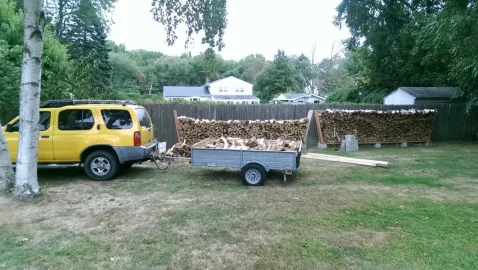

One other thing that helps save my back is to take the split and toss it directly into the trailer on my lawn tractor. Saves throwing it and then later doing all the bending to pick it up and put it into the trailer to move / stack. Buddy and I do this all the time now, we both have tractors, so we get 2 trailers full, then go stack, then come back, rinse and repeat. Other little tricks like moving the splitter to where the rounds are stacked then taking them off the top helps. little things have made a big difference for me and my sore old back.
I've done both splitting and tossing into the trailer or into a big pile. I don't mind either. If I go with the pile I just wait a few days to stack. I have a double gate into my back yard that I can drive right thru. I only do it when the ground is hard. My lawn mower is a commercial machine so there's no hitch. I am thinking of buying a used lawn tractor off Craig's list on the cheap and using that but I hate cluttering my yard. I split in the driveway for ease of cleanup and then stack out back.
