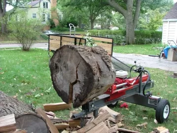

Given the choice, you want fast cycle time over tonnage. A 4" cylinder with a 9hp/16gpm setup (like the Timberwolf TW-2/2HD) will outproduce the same cylinder with a 11gpm pump (like my TW-P1). And either will outproduce the huge 4.5", 5", or 6" cylinders that you see on some of the other units. These big cylinders require big pumps (22gpm, 28gpm) and big engines (18hp+) to produce a reasonable cycle time.
I have yet to find anything I would want to burn that my little 5.5hp Honda GX/11gpm/4" setup can't handle. It did stall on some twisty-grain, 30" diameter semi-rotted elm, but then again I wouldn't want to burn that crap anyway. But oftentimes, with straight-grained wood, the splitter has such an easy time with stuff that I am left wishing I had a 6-way wedge rather than just a 4-way.
  • [Hearth.com] splitter,  i'm so confused.....
in wanna know how the **** u got that log up there???? do we have a paul bunyen in the forum??
