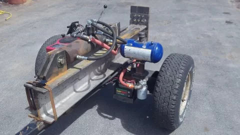

I welded a cpl 5/8 3/4" ish nuts on mine.
  • [Hearth.com] Splitter teeth/stabilizer needed, wood slipping when splitting
