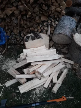

I know it's not ideal but I was given a few rounds of pine that fell from a storm less than a week before I started working with it. By far it was the worse case of the wedges getting stuck. I've spilt pine before that was several months old without trouble like I had yesterday. I'm going to use one round as a splitting block for now.
I moved the other in an area to work on next year. It wasn't as bad after I cut the round in half. Were the wedges likely getting stuck because the wood was relatively fresh? The knots in the one I'm now using as a splitting block didn't help.

I try to wait until green pine freezes to split it, splits much easier, the colder the better, it pops really nice at -40.
Yea I'm thinking splitting it when it's frozen. But jeez - I respect you for splitting wood in that kind of temperature! It was in the low 60s here yesterday. Too warm for November and strange. I'm ready for winter.
Meh, you learn to dress for it, I like cold better than heat, cold you just keep adding more layers, in the heat there is only so many you can remove.
The other thing I'd suggest is using a splitting axe or maul, seems to work best for our softwoods, I don't know anyone here that uses wedges.

Fiskars maul works well on my southern pine to split the rounds. Then I switch to a lighter tool. When it gets stringy it’s not easy. I don’t split it small either. It dries fast so big splits are fine by me.

I have a Fiskars maul. Usually that's all I use unless the round is large in diameter. I also like cold better than heat. Much more comfortable in winter.

That's what I experienced - the Fiskars kept getting stuck. Of course after cutting it in half and then some it wasn't too bad.
Usually the Fiskars is great - off hand I don't know the model but it's only 6 lbs. I think it works better than my 8 lb maul. Then again - maybe sharper isn't better with new pine. The 8 lb maul isn't as sharp and may have worked better in this case.

Green pine can be a sticky mess until it dries awhile.

I burn 100% pine and its a bear to split when green, unless you are using a splitter.
The good news is that it seasons quickly once split, and if you split it by this spring it will be ready for next winter as long as you keep it dry.
I think yes.
I've got 4 acres of 60 year old red pine. I'm learning that it can be tough to split when green, sometimes nearly impossible. If I let the rounds sit a bit, it splits much more easily. I'm also learning that my red pine will NOT dry left out in the open (in the woods), seems to absorb rainwater too readily. I need to get it under a roof! Woodshed coming in 2021.....
