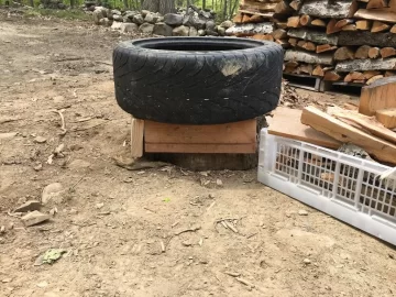

Get a round and screw a tire to the top so you don't have to bend over and pick up all your splits from the ground.

As everyone has suggested, get yourself a round to use as the base. Maybe the guy you buy firewood from can supply you with a round. I am sure he has plenty of them. Make sure you get one that is notty as well. I used a straight round and my fiskar went through the first round then the second round into the ground. You also want it to be like 8 or 10 inches tall so its not making the round on top too tall to hit. Also, get yourself a fiskar x25 or x27. A lot easier to use then an 8lb maul and will split all those big splits like butter. A maul is more for breaking the big rounds into splits but the fiskar can do that as well. :)
QUOTE="blacktail, post: 2163513, member: 18611"]Get a round and screw a tire to the top so you don't have to bend over and pick up all your splits from the ground.
View attachment 195483[/QUOTE]
WINNER!!!!!

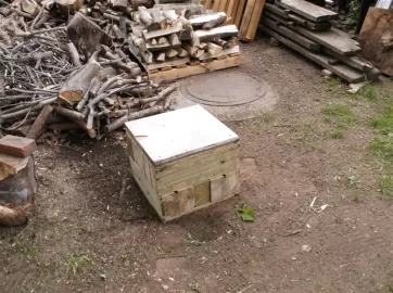

This is the setup I'm using. It is a ash piece.
[Hearth.com] Splitting surface
It tends to not split, since the energy is expelled into the round you are splitting. Should last a while, I've had this one for 3 years.

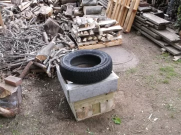

I made this splitting block, it is PT 4 X 6's nailed together, with a 2 sacrificial pieces of plywood on top, and a tire to keep
the rounds in place.
