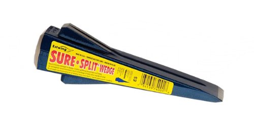

I've never used a splitting wedge, but need to buy one for these stubborn big hemlock rounds I'm wrestling with. My splitting maul just isn't getting the job done.
Do the wedges with the different shapes, the bullet wedges or twisting wedges seem to make any difference?
Thanks in advance. Here's the Stihl wedge as an example of what I'm talking about: (broken image removed)
I've never tried one of the twisting style wedges but remember reading a few good reviews on here of one that was extremely expensive.
This one was the one mentioned I believe, by gransfors bruks for $80!
(broken link removed)
Only thing with the stihl one that surprises me is aluminium. I only ever remember using aluminum felling wedges, but perhaps it is some alloy that can withstand getting the poo beat out of it.
Only advice I'd add is that 1 wedge with me inevitably wound up getting me in trouble at some point (wedge buried). I learned to never start using a wedge unless I had at least 1 back-up with me.
Had a day where I had gotten every wedge on me and my maul stuck in a nasty log I should have thrown over the bank. Had my buddy not shown up when he did with more equipment, I was so mad I would have started a fire right there and burned that log right on the spot to get my stuff back! Even if it meant a new maul handle! Very frustrated. One of those days I can look back at and laugh now.
If I were to buy more than a basic wedge again (although having some as cheaper backups is good) I'd be tempted to try the estwing http://www.amazon.com/Estwing-E-5-8...id=1385510300&sr=8-1&keywords=splitting+wedge

I would get a grenade and several standard wedges. The grenade is nice because it's as wide as the hammer head so once it's buried in the wood you can keep smacking it.
I also would say get a BFH in lieu of beating them with your maul...
Reactions: pen
I only split by hand and I've gone through a few wedges. Over 10 cord split and stacked now and several cord now in ashes. I've 2 of the Sure Split wedges and they are okay, but not great. I've had them launch after the first strike and fly 30ft! Thankfully they missed me! They tend work well in woods like ash and just okay in oak, hickory and the like. The biggest problem I've found with wedges from most stores is splitting edge is ground at different angles. Most are made in Mexico or India, most likely by kids whom have never seen a tree in their life and have no idea what they are making.

i have two eastwing wedges and would recommend them over any other wedge
I think I have at least 6 or so wedges including 2 Eastwings. All but the Eastwings are 4 lb. wedges. I bought them from various retail suppliers around my home. I search through their full supply to find 1 or 2 wedges with the splitting edges ground to the same and correct angle. Sometimes I may go to 3 or 4 places before I can find a couple of wedges that are correctly ground. Sounds picky I know but when the wedges have their splitting edge ground at different angles they are a pain to use; hard to start and tend to bounce back at you. I'm not one to pay money for something I have to bring home and rework before I can use it.
