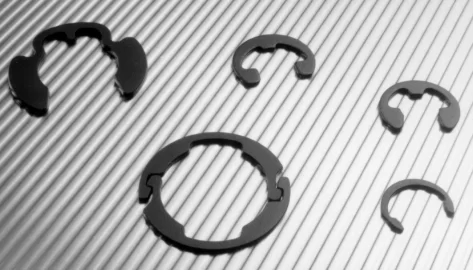

If it was me, I'd probably go get my dremel and a carbide cut-off blade (please note that everything *I* would do would void the warranty on something; this is kind of a constant with me)- slide the handle on to where I wanted it, scratch a mark on the handle in the middle of the base of the spring, then go get a retaining ring a little smaller than the handle, and notch the handle for the retaining ring. Push the retaining ring in through the springy.
