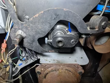

See the blue arrow in the attached picture, this roller bearing is behind your auger motor, may want to give it a bit of grease on the surface from time to time too (your pusher arm will not have the weights that can be seen on this one depending on how old it is).
  • [Hearth.com] Squealing auger... read lots harman p61a
