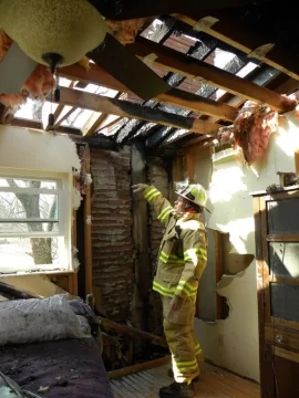

I would bet that the majority of issues with clay liners are with poor workmanship, cutting corners, ignoring code, chimney fire damage and age. That covers a whole lot of installations, this one included that failed dramatically and almost lethally after 34 yrs..
