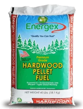

btw:
soon as the weather stays brutal cold steady, I'm dying to try these out...
Made by Energex from the finest sawdust possible... limited quanity each year so they Only sell to selected stove dealers which I assume means the same customers each year.
0.5 ash.... we'll see...paid 250.00 ton back in the early buy spring...didn't come in till last month.
bought 2 tons..

btw:
bought 2 tons..
Good luck with them !! If I can get a few more of these AWF white pine Super Premiums I will pick them up in the next few days. Then around Thanksgiving I'm going on the Energex Hardwoods. Gonna be cold tonight compared with recent weather, dipping into the mid 20's from what I can tell. Ya it's coming.

I have 2 ton Energex hardwoods in the basement...
very hot!!! also a bit ashy but the heat is worth it. [if u never burned them]..
Ya my stove got a pretty good diet of the hardwoods last year, same as you I thought real hot pellets fairly ashy. It's OK I'll go through this ton and then on to the DF's we have stored at the dealer. DF has next to no ash but neither do these AWF Super Premium I'm burning now ( less than .25% ash it says on the label and they mean it).
