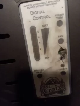

Does your control panel have dials or look like mine?

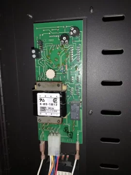

I just remembered i had a spare Breckwell board i was going to loan you to test the stove, now im thinking you may need a harness because of the connector on the board. Need a pic of how the harness connects to your board

This is the back of the original analog board! Thanks for all your insight!

Unfortunately my board wont work. That is an old one with the six pin connector mine is a 10 pin. You may have to change the harness to use a newer board
