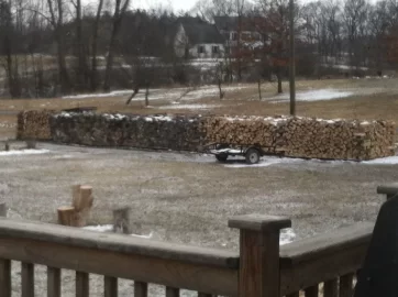

Oak over here - all others over there. Once you get to 3+yrs it really is not as important because it will all be ready by the time you get to it(at least mine is) Oak is just so unique in its ability to test your patience that separating it makes life easier.
This is part of my "all others" - I wish I had that much oak!!

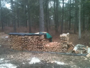

I do stack my oak and pine separate and what little maple I get goes in with the oak. Sassafras when I cut some also gets its own stack. First pic is 20' of oak then 20' of pine[Hearth.com] Stack by species?

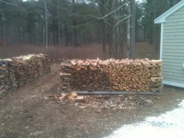

The next is 12' of oak[Hearth.com] Stack by species?

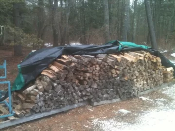

Then the start of 40' of oak[Hearth.com] Stack by species?

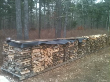

Last pic is what's left of this years 4 cord of oak. This years pine is all gone. As you can see I am getting better at stacking. :-)[Hearth.com] Stack by species?
