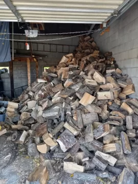

I love your bravery in posting this. An unruly pile like that is practically blasphemy around here!
I like being blasphemous. Wood I brought in tonight was ash at 6.8% moisture pine at 6.8% moisture and some silver maple at 8.something moisture. All split and stacked within last year. So it works for me.
Reactions: dafattkidd
Wow. Is that measured on a freshly exposed resplit surface?
Yes. There is definitely wood in that pile in the upper 20s and 30s for sure. Just threw some 56% maple chunks towards the top. I just take my mm out there when I gather to bring inside. And try to grab chunks that test less than 15%. Then when I split my smaller filler pieces indoors I recheck some of them. Not perfect system by any means but it works
