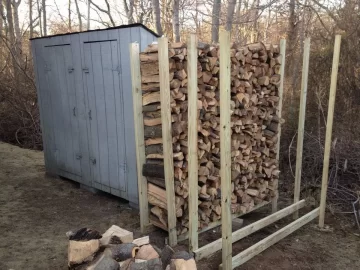

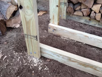

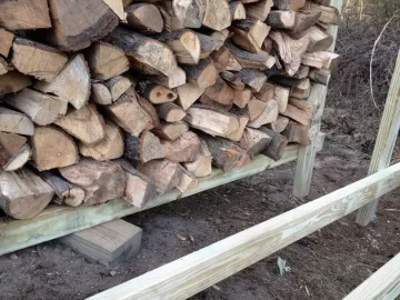

I just built a few racks this past weekend. I simply bought treated 2x4's. 10'ers for the posts which I dug 2' into the ground, then 8'ers for two bottom rails. I bolted the bottom rails to the posts on each side with 2 1/2" 5/16" lag bolts. I jammed a 4x4 block under the middle of the supports to suppor the long 8' span and handle the weight. Sturdy as can be, 8' high stack, 8' long, by 16" wide(log lenght). $80 for wood and bolts, about 1 hour to dig 2' holes with a post digger and bolt them together. Will likely last for 20+ years.
