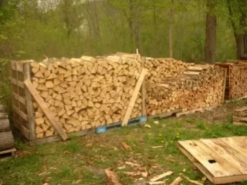

I don't have any level ground either. I terrace/step the pallets by setting the downhill edge of one pallet on top of the edge of the next pallet. If the slope is steep enough that the pallet still isn't level put a 2x4, or something, between the two. You may need to support the span of the pallet (now in the air), if it's a long one, by shimming with rocks or something. I'll try to get some pics of mine up tonight.

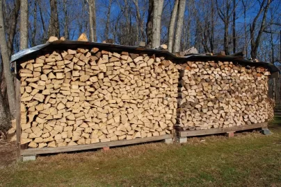

I use 16' PT2x4's with metal ends from Home Depot. It only take a few minute to set up, and it very stable. I shimmed them up with scrap 2X4's where the ground is uneven. They hold 2/3 cord eack stack.

Here's the stepping I mentioned:
  • [Hearth.com] Stacking wood on 2x12's & 2x8's etc..instead of pallets

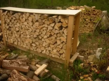

If you have access to cheap/free lumber you could make something like this with longer legs on the downhill end:
You can use treated 2X4s and save some $. I use the treated landscape timbers from HD that cost $2 each for an 8' length and set that up on 3 cider block. I have a rune that is 24' long and I use 1 block where the 2 pieces butt together. The cinder block raises the wood up en ought to keep it dry and to allow air to flow under it.

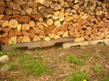

Under each row are two 8' poles. Each stack (cut at 16") is 3 rows of wood stacked 4' high and 8' long so that each cord of wood has 6 little saplings under them to keep the wood off the ground.
Not sure how much more low cost one could get for stacking wood off the ground and I feel it looks even better than using pallets. If I ever get done stacking last winter's cutting I'll post it but most of you have seen a lot of it already in some of my earlier posts.

Nice stacks guys, my stack was built out of scrap wood about 7 years ago (cost me 10 bucks for lag bolts) It's still holding together for now.
Hey Lefty, If your split/stacked off the ground and a year ahead all is good.
WoodButcher
