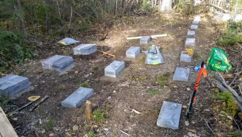

Hi - I'm new here, and it seems I'm in the perfect place to ask my question!

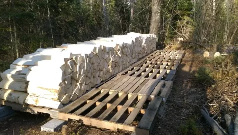

We have uneven raw ground that we're building a pallet woodshed on. Dimensions are 24x8. To create a level "surface" for the pallets to rest on, we've used concrete pavers. Each pallet rests on part of a paver on all four corners.
My questions is: being that the pallets aren't fully supported, how much weight will they be able to handle? We had intended to put around 24 face cords inside - utilizing the entire space up to about 8 feet high.
We're now wondering if we need to go back and place more support under the pallets.
Your advice sure is appreciated!

I would put a few in the middle, since the majority of the weight will be in the middle of the pallet. Pallets are designed to be supported, not floating.
Reactions: LisaGergets
If you want to stack green wood 8 feet high I would definitely want support under the middle. That said, the way split wood interlocks when stacked you could probably get away without center supports. But this will stress the pallets and shorten their useful life. They look to be in good condition now but they will weaken with age and you'll wish you had center supports. I would put one front, one back. Also, unless the wood is already <20% moisture content, the stacks should be better ventilated (5 inch gaps between).

Joking aside, your pallets will sag in the middle without some support. A couple well placed stones or even just ugly splits would help under the center line of each pallet. No need to spend more money on blocks, just run what ya brung.
At 24 face cords you are in the major leagues now and can just say " 8 cords" or whatever.
Pallets with cutouts on the sides for forks are only going to last 2, maybe 3 seasons supported only at the corners.
With some center supports that life expectancy will increase.
After you are saving real money from your conventional heat bill, use that money to upgrade the flooring. Pallets will last long enough to put money in the bank.

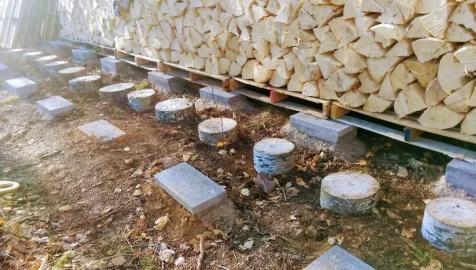

Thanks so much, guys! This wood is aspen and has been debarked, because it will be used next year in building a timber framed home with cordwood masonry infill. We're doing it all ourselves (cleared our own land and felled about 80 aspen and around 20 various pines, too). This particular shed is temporary and only needs to last until next summer when we begin the cordwood infill. Basically just letting it season and lose a little moisture.
When we arrived on the land yesterday to work, we noticed a couple of the pallets bowing under the weight. So, we had our answer! There's a picture of our fix below. We decided to just cut some short lengths of wood and use those to make a level surface for the pallet to rest on in the middle. They are MUCH more supportive now.
The last thing we want is to go check on the wood in the middle of winter only to see that the entire thing has collapsed.
