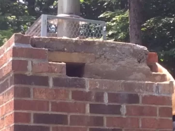

I don't plan to go this route, but would it have been an option to pour a 4" slab on top of my old crown assuming it was structurally in good shape? The only place it failed was at the edges where it thinned to 1/2" over the brick. The rest is massive solid concrete. I would worry about that much weight on top.
Is there a 2x4 in there? Looks like it.
I can see why you say that it looks just like a 2x4 in the picture. Its a yellowed narrow cinder block. Its so thin it makes me nervous thinking about demo-ing that crown (everything collapsing down) which is why I am looking into the stainless chase cover.
I even thought of renting a 14" masonry saw that could go thru rebar but that just sounds crazy to me when I look at the stainless cover solution.

That would bust up pretty quick with a demo hammer. 2 hours at most
What if there is rebar in there and is there risk of the whole thing collapsing?
The angle iron is only supported on the brick by like 1/4 inch and there are thin cinderblocks also used as supports for part of the crown.Looks like a bunch of dominos waiting to fall ?!

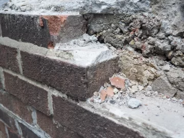

How would you remove this mortar bed from the top of these bricks so I don't disturb the brick itself? A chisel might loosen the brick which I don't want to happen.

If using a grinder would you use a diamond blade with no guard/shroud?
Diamond blade yes but absolutly use the guard.
Will a 4 1/2" angle grinder get the whole top surface clean without the guard? I can't get at both sides of the brick with the crown in the way on one side.
If you angle it you can clean the whole surface

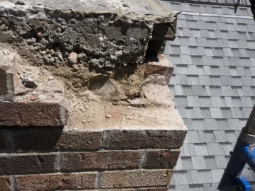

bholler can you tell me if you would change the top course of brick so they are even (moved out) with the two corbelled layers below? Not sure if you can tell from the picture but the top layer is shifted 1/4 inch in from the next two layers.
Would't that make more sense since I plan to put on a chase cover and the skirt will look better and fit better?
Yes i would corbeling in on the top of the chimney is absolutly horrible for durability

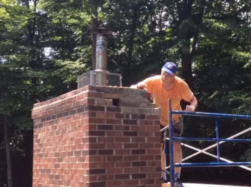

And btw why is your liner sticking through the cap and so high
I added 3 feet of pipe because the Woodstock Progress was backpuffing. 3 feet made all the difference.
I checked the pipe today (it was last cleaned in January) and there was absolutely no buildup of soot. I know - it should be Class A but I have been running it this way for years and I never get buildup. I clean it midway in Winter every year.
