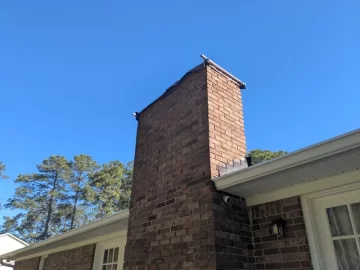

Stainless steel chimney crown cover
Great, thank you!
So I looked into a mason for the fun of it; my wife isn't thrilled about me doing it myself. :-)
The contractor went up there on the roof and I thought he stated right away he would replace the entire crown. But with his proposal this morning, I am not so sure that is what I am reading for $750.00.
Repair of cracked chimney crown on a one-story home.

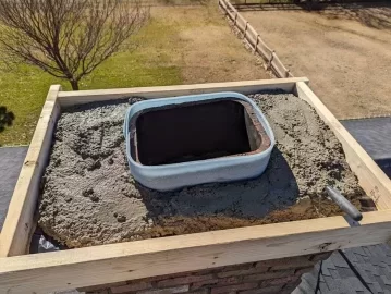

I typically use metal adjustable forms. But when I need to use wood I usually attach the 2x4s on the ends with a couple tapcons then attach everything to them
The blue wrap is for an expansion joint so the flue wont crack. Mine was built without it and never cracked but was never used as a fireplace, the Wood stove always had a SS liner which must have prevented thermal expansion of the clay liner.
I honestly don't know what the purpose of the plastic sheet is.
I see. Like this guy did at 35 seconds into the video
or here at 46 seconds
One of the comments on the latter video stated he avoided screwing into masonry, but I could not visualize it.
"’ll generally use 2x4s at the base cut to the length and width of the chimney to create the drip edge and then screw in with 2x6s attached to them on the outside to contain the concrete . That way I’m not having to drill into the masonry at all. I also have a metal set of forms I purchased from Copperfield Chimney Supply years ago that also work great and are still holding up well . Keep up the great videos sir !"

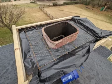

My son-in-law comes over tomorrow for us to decide the master plan. One of the practical questions I discovered is how one mixes all that cement. If I went with a sand/mix prior to a chase for long-term, I would need about 8 bags to do 6' x 3' - 2 inches deep. I would think it would start drying before I was finished getting it all spread out. That's a lot too to carry up the roof. -- I can't imagine how one does a full crown. That would be a cement, sand and gravel mixture even deeper.
The idea of smashing out the old crown, mixing all that cement, hauling it up 2 stories, building the form and internal rebar.....all led me to the simple <$600 SS cover solution. Sure a solid Masonry Crown looks better but I never thought twice I should have gone the other way.
The hardest parts for me was making sure my measurements for the cover were absolutely correct, and figuring out how to get the cover to sit properly while fastening.

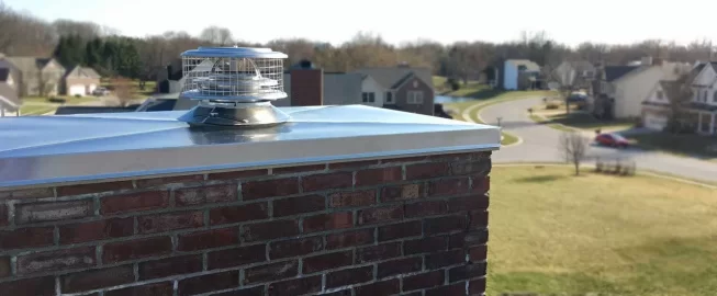

Here are two pictures of chases. The one without a flue is sort of what I am thinking to install. I'll take any pointers you can give me. :-)

For the future, I would not do a ventless gas insert. It vents the gases (a lot of water, combustion products, so CO2 and anything else if combustion is not perfect, which it never is, and if things go wrong CO) into your room.

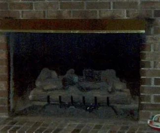

We hardly ever used our older style ventless gas logs. The idea is a backup if we have a power failure in the winter, we would have heat. We have a gas furnace and the natural gas line is already hooked up in the chimney. I have the line capped now with the chimney currently vacant. The two chimney inspectors said to go the insert models in the future.
Go with a vented insert then not ventless
A little confused. Vent-less = vent-free which we have currently have as pictured.
Vented means I would need a working chimney. Unless you meant a vent-less insert.
