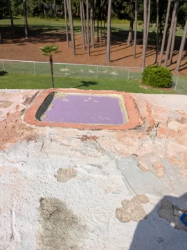

Trying to again visualize the mounting procedure I need to follow before carrying the chase to the roof.
I understand I can purchase stainless steel tapcons and could use stainless steel washers.
My chief concerns are:
1) How long of tapcons should I purchase and the diameter. Intend to go into the brick.
2) If I pre-drill any or all holes in the chase, which diameter should they be?
3) How to I make sure my holes line up with the holes I have to drill for the tapcons? I understand there is not any room for play with tapcon screws going into brick. The alignment is a big concern of mine.
4) Spacers - I assume I should have an array of different lengths? Possible the PVC pipe could be cut to length on-site on the roof.
I plan on purchasing a HF Brauer Hammer drill and I already the an impact driver.
Son-in-law might offer his services around Father's Day, so I want everything ready to go if he volunteers.
Yes, if you have the cap attached then you don't have to line up the holes so you hit brick. You could preplan it all too, and drill all the holes in the stainless first before taking it up.
I don't like adding extra stuff on brick as it makes a mess. You don't need to trap moisture in there either. Hopefully the gap is small enough a bird can't get in. When I put a home made cheap caps on mine I blocked the flue first. Someday I will do something better. I had to do that on the wood side to get insurance. The side on the left was for oil.
Tomorrow is the big day, chase going on. Forgot what you meant by, "if you have the cap attached then you don't have to line up the holes so you hit brick."
Today I sealed some holes in the crown with mortar and insulated my flue. Double layer. Made spacers out of CVPC. Lots of prep work getting supplies, etc., so hopefully goes well tomorrow.

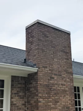

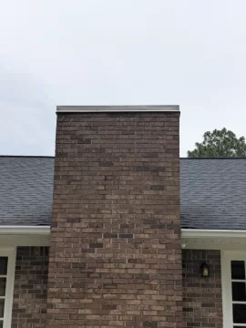

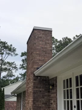

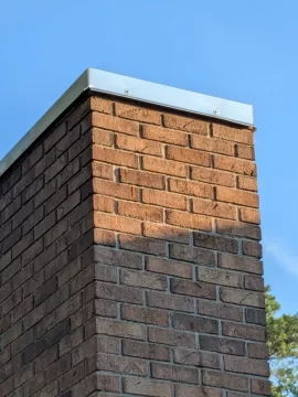

Update: Chase is installed. Like a glove actually and made me sweat a little. Turns out on the long side the brick bows out a wee bit. But my son-in-law and I were able to get it on and screwed down. Stainless steel tapcons and stainless steel washers. The front side we had to climb up the ladder quite high so we ended up getting the latter a bit too close to the drip edge (my OCD). Once on the roof we had more leverage to move them up a bit. It's not going anywhere.
Thank you for everyone's input. Couldn't have done it without it.

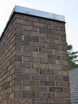

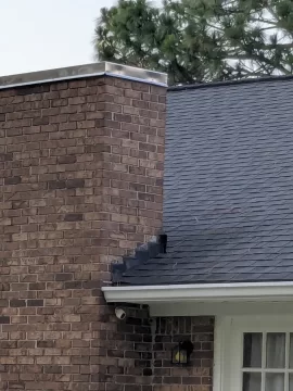

Ok, I am not telling my wife yet, and maybe its just my OCD. Since my helper installed most of the tapcon screws (not blaming him as he was not as afraid of the height as I was), I've seen at some glances reflections that bother me that perhaps the screws should be backed out a little. What do you think? If so will backing tapcons out a little break? Second picture is at a different angle than the first.

No responses either means Much ado about nothing which is re-assuring. It does look like a light reflection thing. Just never occurred to me such contrast could take place. This picture is from another time of the day. Go figure.

yes, the edge is a bit pulled inwards by the screws. That's good, it keeps tension on the fastener, so they won't easily vibrate loose.
It's a chimney, not the kitchen countertop. Beauty/perfection standards are different. Countertop: appearance matters. Chimney: mechanical construction matters more.
