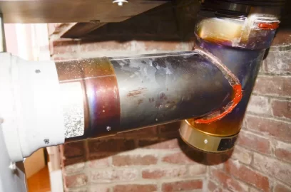

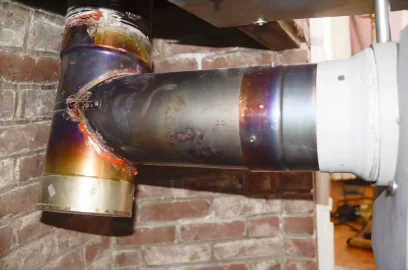

Ok guys you obviously know more about the properties of the metals used in the liner products than the engineers from olympia i just talked to last week I apologize for the misunderstanding
I can't understand why in that pic the tee and snout are discolored but the liner appears to not be discolored.
That is what led me to suspect the downward slope of the snout. Using an IR thermometer, I've found that heat pockets at the top of the pipe when this happens. My guess is that this is due to the slowing down of the hot flue gases.
That is what led me to suspect the downward slope of the snout. I have found that heat pockets at the top of the pipe when this happens.

last week I contacted Olympia Chimney supply since they are the ones who manufacture the current tee I am using. I first sent their customer service am email, and after their first response, I sent them the pictures I posted in this thread. After speaking with the Operations Manager, she replied back today saying they are not concerned with the discoloration due to it being used for wood burning. See below emails.
Sent: Sunday, February 22, 2015 4:51 PM
To: Customer Service
Subject: Email Form Submitted
Subject:Question
Message:
I have a question regarding a forever flex TLF6 6" tee connector. I have a 1 week old stove and tee connector and I am starting to get discoloration. it actually happened all in one day and I noticed that the horizontal section was no longer level or slightly uphill out of the back of the stove but it was canted slightly downhill out of the back of the stove. what is the extent of discoloration that is still good. What colors are bad to have on the stainless? Thanks again. kevin

Thank you for the quick response. Attached are two photos from my tee connector. Seems that my wife had the air wide open while letting the stove get up to temp. The stove was in the middle of the burn range (500-600) degrees. I think the flames reached portions of the tee. Can you show the operations manager the pictures and let me know what he says? Thank you for your time.

Our operations manager says: This discoloration is definitely abnormal. The steel got very hot very fast. The heat was stuck in one area of the tee for quite some time. There was either a draft problem on start-up or some type of fire catalyst was used to get the initial fire going.
This color shows a temperature range somewhere between 1,500 and 2,000 degrees F.

I noticed the discoloration at the same time as when I noticed that the horizontal section of the tee was slanted downhill and not level or slightly above level like it was when it was installed. I asked my wife about it because she was the one who was burning the stove that day and she said that she had the air wide open (reloading during the middle of the day) and the flames were wrapping up around the secondary baffle. she said the stove top did not exceed 625 degrees during that time. she turned the air down after the stove got to that temp. no fire catalyst was used to get a fire going. the fire was started and has not gone out in the two weeks we have had this new stove.
I started my first burn on 2/13/15 and this did not happen until 2/19/15. prior to that date, there was no discoloration on the tee and I had the stove top burning from 400 degrees all the way to 700 degrees (this is the optimum range for burning with my stove). I started my first burn with crumpled news papers with several pieces of kindling on top, then as that burned down, I added smaller splits until a nice coal bed was formed.
I've spoken to a few stove people and they suggest that since the tee was slanted downward slightly, it let the gasses linger inside the tee instead of letting them escape upward through the flue pipe. causing the tee to get hot and discolor.
I'm not sure how I could have a stove top temp of 625 but have temps in the tee at over 1500 to 2000 degrees though.
I have since fixed the tee to have a slightly upward slant out of the stove so that the smoke/gases will escape up and out of the stove and tee connector.

The stove top temperature and the flue gas temperature will be quite different. There was definitely very hot glue gas stuck in the tee for quite some time. Since you are only burning wood I am not too concerned with the discoloration. The tee is made from 316 stainless so it will hold up to wood fires very well. The reason I was initially concerned is because stainless steel looses some of its anti corrosion properties after it hits elevated temperatures on multiple occasions. It would be concerning if you were burning coal or oil. I do not think you will have any future problems.
