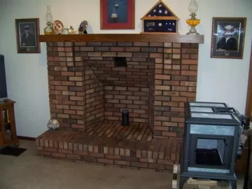

Finished up the front face and overhead, all thats left is the floor but he wants to wait til Friday to take down the form. It's looking so good I don't know if I should even put a stove in there. ;-)

Very nice job. I can see that Keystone is just itching to get on that pedestal. It's going to look great.
Time to go climbing. With a liner hung over your shoulder.
Congratulations, Todd. It is looking great!! The Keystone is going to look perfect there.
The hearth is done. Just have to wait a day or two for the mortar to dry and then it's time to install the stove and liner. I'm going to have a little gap where the pipe goes through and thinking of either more mortar around it or cutting some sheet metal to fit, what you guys think? I can't use a collar ring cuz of the angle of the dangle.

Put a thimble on the hole and use pipe down to the stove. Look better and be easier to service later.
Todd,
This looks really great. If you PM me the angle and the pipe outside diameter, I can use a CAD program to give you an oval pattern you can print-out as a template. From this, you can cut a hole some sheet metal and take your pipe up through it without any gaps. A square flat plate with an oval in it. Paint it black and your good to go.
It looks like a pipe coming up from your hearth. Is that a fresh air intake for the stove?

I have a 45 that comes out the top of the stove and according to my measurements it will be right up next to the hole, so I'm thinking on just bringing the liner and liner connector right to the 45, then need to fill the gaps. The back wall is 45 degrees but the last course angles up to a 90 where the lintel starts so It's kind of unique. Once I get the stove in there I should get a better idea of what's needed.
