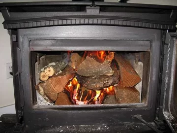

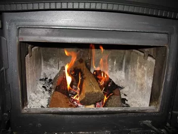

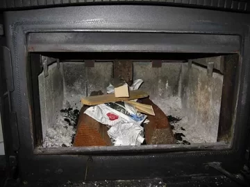

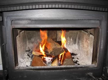

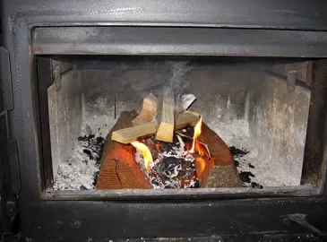

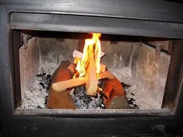

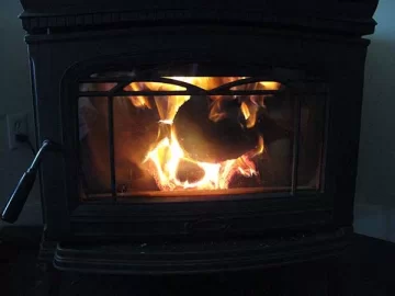

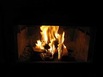

Started a fire this morning and thought I'd document it for folks wondering about different methods for firestarting. This method works well in stoves that allow North/South loading because the air feeds the fire down the tunnel of love®.
Started off with two medium sized fir splits placed about 4" apart. 4 balls of newspaper were placed between them. Then 4 pieces of construction scraps were placed criss-cross on top. I made the kindling by taking a hatchet to 2x6 end cut-offs. Light and let it ignite with the door open a little. These shots were taken 1-2 minutes apart.
setup [Hearth.com] Starting a fire via the tunnel of love® ignite [Hearth.com] Starting a fire via the tunnel of love® [Hearth.com] Starting a fire via the tunnel of love® [Hearth.com] Starting a fire via the tunnel of love®
split added [Hearth.com] Starting a fire via the tunnel of love® [Hearth.com] Starting a fire via the tunnel of love® add wood [Hearth.com] Starting a fire via the tunnel of love® [Hearth.com] Starting a fire via the tunnel of love® burning good!

Top down works too. Sometimes I do it that way just for fun. In this case I deliberately started this fire with newspaper because some folks don't use starter. The total elapsed time was about 20 minutes.Stove top at 30 minutes was around 500 and climbing which is pretty good for this massive beast. I turned the air all the way down and it leveled out at 650F. This is not the best loading job. I'm burning irregular uglies right now so there are more air gaps than I like.

PS: That first load is still burning, about 7 hrs later. Stove top is down to 325F, but it's 50F outside so I'm letting it idle.

Reload 12 hrs later. Not bad for a loosely loaded batch of softwood uglies.
