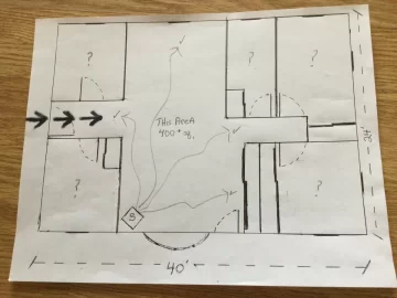

Here it is ...the main area is my goal to heat (kitchen living room) but of course the rooms would be nice too.the main area and two corridors are about 425ish.the stove location is the only place I could fit it-piping is a whole other issue. [Hearth.com] Starting from scratch (pellet stove and install)

In the 400sqft area is there a ceiling fan? If not can one be installed? Conventional thought is blowing down in summer to cool, drawing up in the winter to mix cool and warm air. Conventional is with a forced air heat/cooling system, not a space heater like a pellet stove is. In my house I get better heat distribution with the ceiling fan blowing down in winter.
You will need to experiment with your layout as to which works best for you, whether with a ceiling fan, box fans or a mix of them. You will need to monitor the temps in different areas, allow a few hours to show changes as the walls and other things need to warm or cool and that takes time. It all will affect the air temp but not anywhere near as fast as a furnace will.
Got it...yes there is a ceiling fan over head in close proximity to the stove.good point!
I would think that those two rooms on the far right corner (as the picture sits) would warm up nicely just from the airflow from the stove. Maybe the room across from those too since the heat should travel down that short hall well. IMO, those two rooms to the left will be more challenging - although they should get at least some heat.
Still, it's hard to know exactly how the air will flow around a house until the stove is actually installed.. After all, everyone told me that heat rises - but not in my house :(
Ha...the heat definitely rises in my house,I’m on a crawlspace the only Time my feet warmup is summerTime, when the house heats up for free. Go figure
There’s a room not shown on the left at the end of the corridor.would it make sense to say a stove probably wouldn’t heat all other area’s mentioned.especially since it has a cathedral ceiling and the stove would not be in line with the door.
Once you start to mention cathedral ceilings you are talking a whole other animal. Good luck heating that one no matter what you heat it with.
My old house had a cathedral ceiling. It heated just fine with a woodstove. Never tried pellets as no place to store them. Probably just took some extra time to get the heat built up, even more with pellets so best to just maintain temperature. Now if your cathedral ceiling is poorly insulated it’s probably hopeless.
