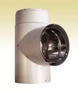

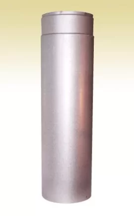

    ICC Excel will fix your problem. Silicone o-rings seal it and it is one peice no joint all lazer welded inside and out with a lifetime warrenty. Also you can {unofficially} cut Excel pipe to exact length if need be, the only pellet pipe I know of that you can do this with and no silicone needed at any joint but the stove adapter at the stove end.
    It is stupid expensive but well worth it and a joy to work with.
