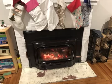

This is a bad idea correct? How hot can cheap fabric get? We did this for a possible Christmas card pic. It’s down now.
Haha. In the beginning I used a cheap cotton oven mitt when raking coals and adding wood and it caught on fire while I was wearing it. It happens fast too.
Yup, clearances to combustibles includes temporary items like stockings.

Clearly I’m in good company. That torch is just about empty I have a propane bottle waiting to go on it, good point should probably keep it somewhere else! Really I only had to but fire to the stove 3 times since I got it in October.
After picture was taken I took them down, wife and kids asked to keep them up. I had to explain it would be a sad holiday season if we all burn and die!

Sometimes things jump off their hooks -- I'd also be afraid that a stocking would fall and come to rest against the glass. Makes a nasty melted plastic lump on the glass that is hard to remove.
I read that wool is pretty fire resistant, if not technically non-combustible. I wonder if wool stockings, hung higher and fastened very securely, wouldn't be a good and fairly safe compromise.
Also: children are dumb as rocks (well, I was anyway). Please put the torch where they can't reach it.
It's only a bad idea if you don't want flaming stockings hanging from the mantle and dropping to that nice purdy wood floor.
Hanging stockings over an open fireplace was a lot safer. I dont remember the song mentioning stockings hung over a woodstove.
