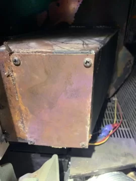

But from my prior outdoor testing and cleaning, I do know that the gasket in the picture below is bad. It may be letting a tiny bit of exhaust out. I can pass a putty knife past the gasket in some place. So I'm going to change it.
Question 1: that gasket looks like a basic rope gasket. I'm not sure it is a good design even when it isn't beat up. Is there a better alternative or should I mail-order an OEM gasket?
Question 2: Is there some other gaskets I should be looking at. Again I don't see any smoke.

I don't know your stove model, and I don't recognize the pictured part and what it does.
But a good rule of thumb is that everything before the exhaust blower motor is getting sucked in (negative pressure), so air and smoke are getting sucked into the stove - so your leak is unlikely to be from that space (unless you have a gaping holes somewhere or open the door).
But once the air wash gets past the exhaust blower motor, it is now being pushed out and pressure builds in the exhaust channels (positive pressure). So you want to look in the paths where the pressure is pushing out. This most likely where your leak is coming from.
My stove leaks a tiny bit on startup, I can barely see it, but once the fire gets hot and the draft heats up, I smell nothing. So you shouldn't be smelling anything after start up.
Also consider that your smoke smell may be coming from outside somehow, a crack in a window or door.
Look for the owners manual online and see what gasket the manufacturer recommends for that pictured part.

That pic is the clean out plate. kap
Have you tried tightening the screws?

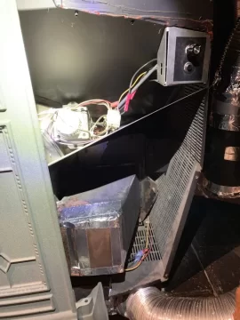

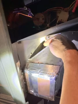

I taped up the cleanup plate in order to see if that changed things....
I have posted two pictures.
Sealing the clean-out plate (which I am 100% convinced was leaking because the gasket was not complete), revealed a leak where my finger is in picture two. It was coming up from behind there. I could not exactly see it. Once is saw a bit of ember come out from somewhere back there. I feel like it might the exhaust blower.
There is some space around the pellet drop chute, but I don't think that matters. Is that correct?
Thoughts? I thinking that I'm probably going to have to pull the entire guts out of the back to fix this. In this case could somebody suggest if there are other parts or gaskets that I should replace while I"m in there. Im not looking forward to it, but I can't have a smoke leak. I suspect the 2006 stove just needs an overhaul even thought they didn't run it very much.
