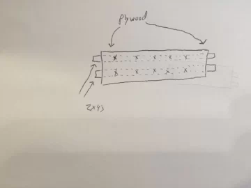

I'm not really very handy with building things.. But is this what you guys had in mind?
This is a top view of what I would build.
Plywood sitting on top of 2 (2x4's) the X's indicate where I would screw it down.
Would this work?

My garage floor gets wet from water or snow from the parked cars. Another reason to keep them off the floor, at least for me.
you can use the 2x4s in short sections running front to back. and you needn't even screw the plank down.
just getting the wood up from the floor is probably all that's needed. but short "scabs" will allow more air circulation under the plank.
you may be able to find short pieces as scrap too. saving a few bucks that way.
either way will be fine though.

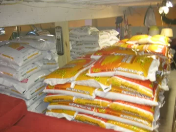

all these tons are sitting on wooden skids in the basement..

First year pellet user (Harmon accentra 52i) received my pellets... Wtf... They take up sooooo much room. Where do you guys store your pellets?
I store between 4-5 tons in garage ..
