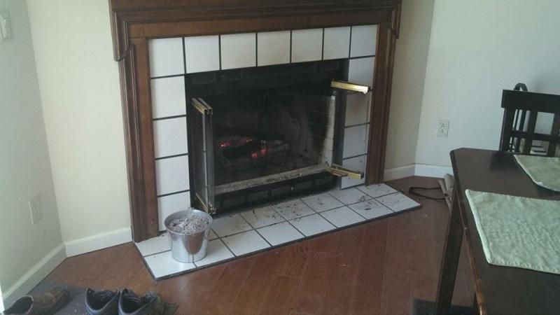

Here's the piece of junk prefab fireplace that was in the house when I purchased the place a year ago.
[Hearth.com] Stove and hearth project

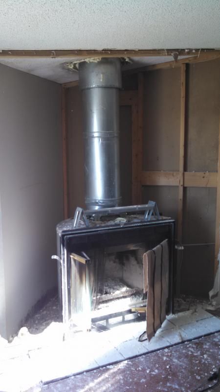

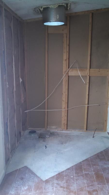

Screw that! We started tearing out.

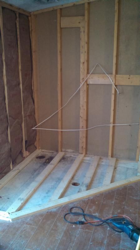

With a clean slate, I built a relatively short but wide pad.

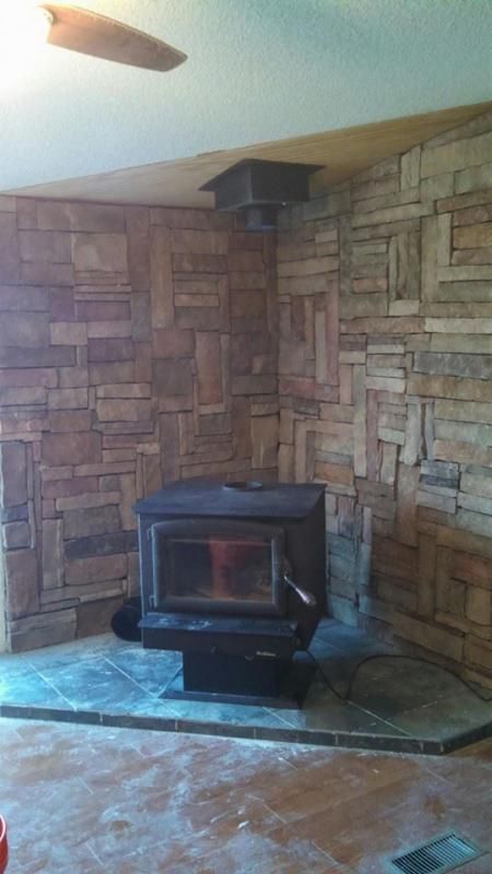

Almost done!
Done!

Looks great Steve, similar color to the tile I used for the base. It may be the angle but is that 16" clearance in front of the stove?
No, I didn't want to make the pad any bigger, so I'm using a piece of stove board that I can move in the warmer months. It's allowable in my county (in Ohio), but I understand some codes require the front ember protection to be fastened to the floor. I just ordered it and it should be here this week. Hopefully it beats the really cold weather because I can't burn without it!
