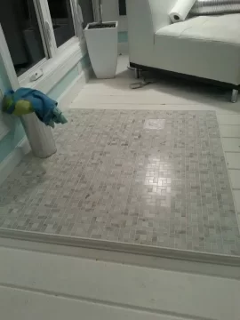

It's all down and I grouted last night. Here's a picture. the large tube is just a grout form to keep the 5" combustion air duct clean.
The chimney connector should arrive today and I hope to set the stove in place and perform my 1st burn tonight. I told my wife that this light tile will get dirty, but it's her choice, we'll see.

Looks good, you'll probably see less dirt on that light pattern you have than something dark.
