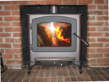

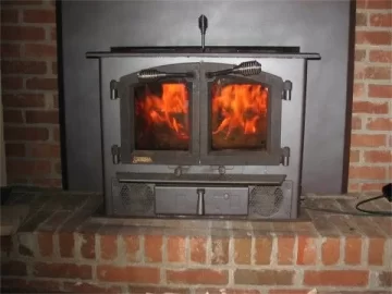

I post this one more time Craig is gonna start charging me for disk space.
The old and the new.
  • [Hearth.com] Stove Bright dry time??
