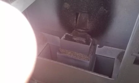

Hi there! I’m an old retired geezer myself!Just wondering what needs to be done on a daily, weekly, monthly basis. Just started the last few days. I just shut er down and sweep it all out with a shop vac after a couple of hours. Thanks for all your help.

You need to tell us:
Name and age of stove!
A picture if you can.
When did the stove last run and do you have Any problems?
Owners of your type stove will chime in with the best cleaning schedule.
Welcome.....Bill

Hi Hiskid, welcome
here is you stove's manual with the MFG's recommended maint on pg's 30-33
(broken link removed)
If you find a pellet that burns clean and don't clog up the burnpot there is no need for daily cleaning and you could actually scrape the pot without shutting the stove down. Where the Serenity is awesome is that there isn't much to clean other then dumping the ash pan and vacuuming the firebox as needed. Every ton it's suggested to remove the exhaust blower and clean it along with the exhaust vent. For me I found it too soon at a ton and went 2 ton.
Yes there are pellets that burn that clean combined with getting the stove dialed in. Don't waste the money on the green teams though they are just an average pellet.When scraping the pot you just leave a few burning pellets in the pot to keep the fire going.

yes that is how I scrape the pot, sorry I don't have a video but I would like to put a serenity video series together some time

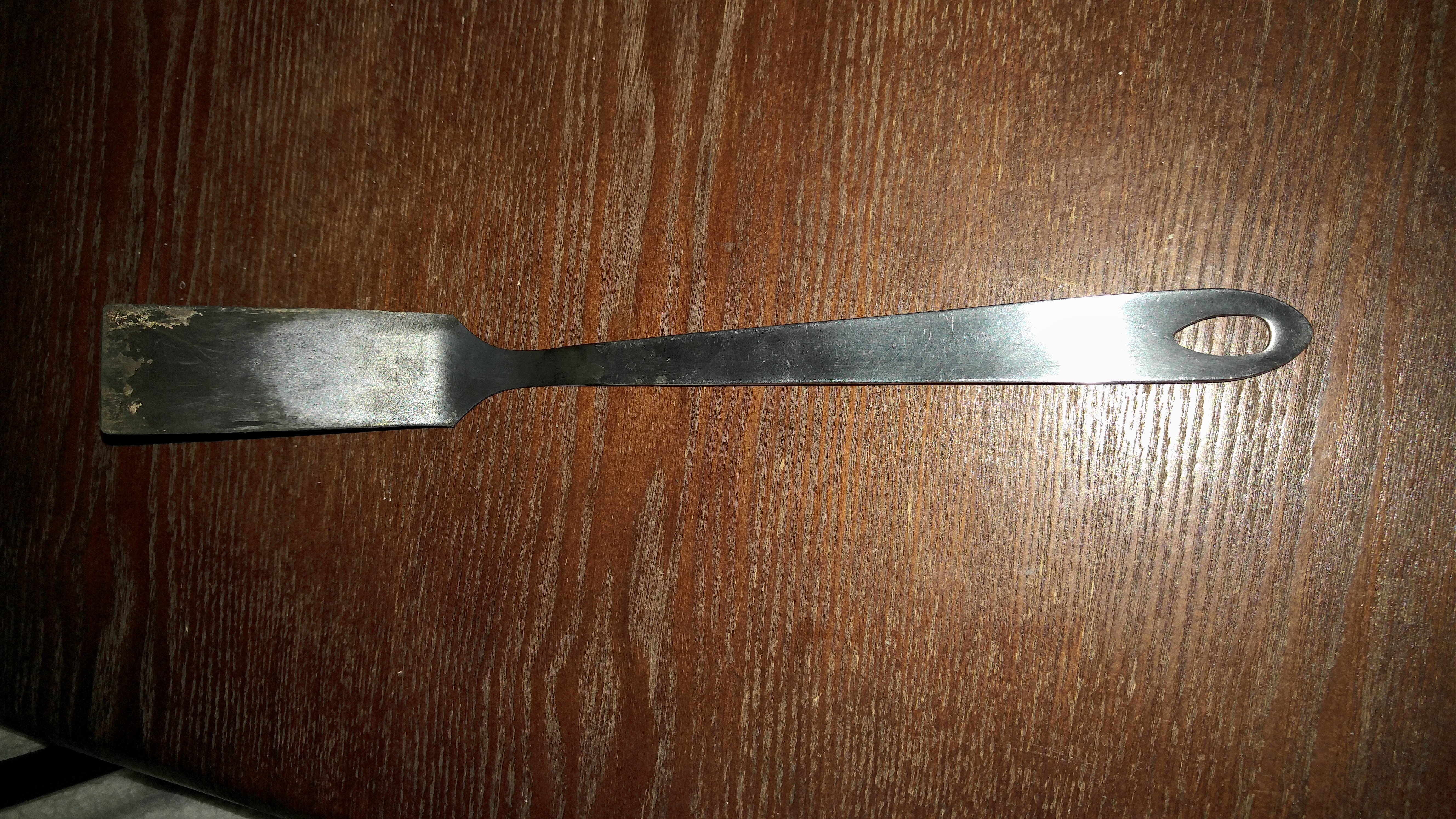

I don't know why the Serenity would be a whole lot different from the Harman P series stoves. I shut the p61 down every couple of weeks to clean moving parts and dump the ash pan, otherwise I just turn it down low or wait till it goes on it's own low cycle, and take an old paint brush and quickly brush down the ash from the heat exchanger and sides of the stove and the shelf that's inside the stove right into the ash pan when using box store ashy pellets ( hint, wear gloves). I scrape the pot every few hours, you just scrape right under the hot coals and not scrape them out. Scrape the ash off into the pan. Harman stoves ship with a tool to scrape the pot with, it sucks but they supplied one at least. I went to Harbor Freight and bought a good beefy screw driver to scrape the carbon off the pot with. Works great. The pot configuration might be different on the Serenity, the Harman builds an ash line ahead of the burning pellets as they get pushed out.
