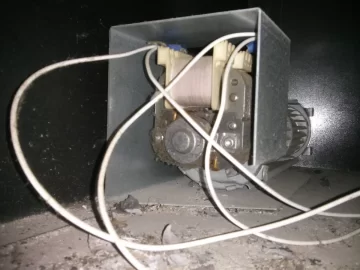

Electrical engineering is a very complex subject. I dont think you need to learn all that. @jetsam was right except for this particular motor. Do you realize how many different motor types there are? Take a pic and show us your motor if you arent sure. Speed control of a SP motor is best accomplished through lowering the voltage. The rheostat is resistive and creates a voltage drop. Very simple. An Incandescent dimmer you buy in a hardware store will NOT suffice. They interrupt the current in pulses and that will burn up if you use those as @jetsam said.

Yes sir. That is a SP motor. See the thin copper bars on each pole? You are good to go.
