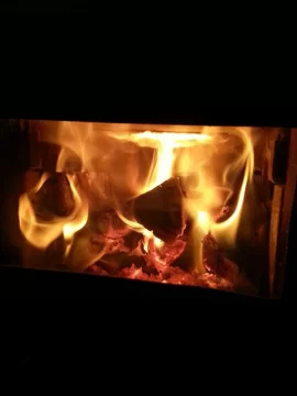

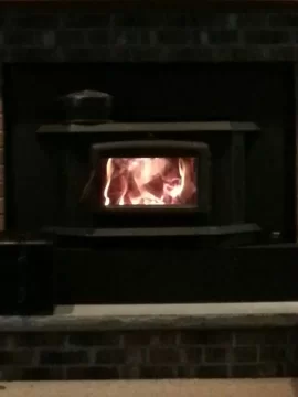

I have a PE super insert, i loaded it up tonight at 11pm got it going for about 20 min stepping it down until i closed there air all the way down at about 400F. For the next 40 min the temp slowly rises until it reaches to 750 and the metal in the upper right that also holds the firebrick in turns red! I have a very good draft as always and i seem like i can never turn my air down enough. I attached a pic at 12 midnight of it shut all the way down. It seems to be way to much flame. What do you guys think i should do?

From the pictures, it looks to me like the splits are too small and/or not packed tight enough- too much air space. Nice flame action though.
Bigger splits, for sure. Turn the air down sooner. I generally have it shut down quicker than that on a cold start. I don't go by temps as much as the way the fire looks.
This. Once these stoves really get going it's hard to slow them down (AKA going nuclear). If I let mine get too established before turning it down it's a battle to get it to stay below 750.
And it appears that you may have load just a few smaller splits on a large coal bed. That is a recipe for big fire.
