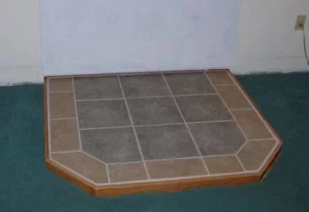

I plan on making my own. I have a certain tile in the same room that I would like to match.
Is it is simple as tiling over plywood? Then rest that on my hard wood floor or is there something else that needs to be considered?

Thats how I built mine.
Be SURE you can pick it up after building, good thing I'm a gorilla and the neighbors kid is too. I built it in the basement and started thinking "How heavy is this thing" when I was grouting it ;)
