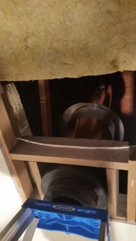

Just got done stuffing some mineral wool batts in the cavities adjacent to the chimney to keep the loose fill cellulose from encroaching. It is every bit as itchy as fiberglass. I used so much PPE my wife called me king tut. So far king tut, wiley coyote, pig pen, and pink panther have been referenced in this project.

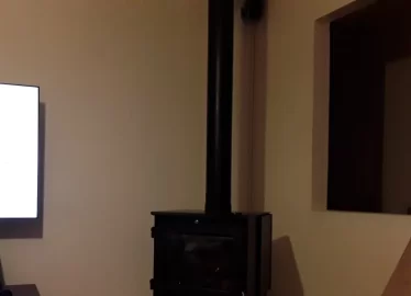

I switched to a projector so I wouldn't shorten the life of my TV. I even had to get a slightly higher end (mid range, more like) projector screen. The cheaper ones are PVC only or PVC and nylon. They expand and contract too much with heat, so I'd get ripples and waves. I got a Elite brand with fiberglass substrate instead, and it's much better.
The best thing to do is just see how warm the area the TV is in tends to be. If it's more than 30 degrees F higher than the room, I wouldn't put the TV there. It will shorten its lifespan by some percentage. Electrolytic capacitors and eMMC chips in particular will die faster with increased temps.
Reactions: trx250r87
The definitely would worry me since it's a free standing stove. I have electronics about 3' from from insert on thr same wall but they don't really get hot because the heat is radiating out and the blower helps. Your stove is going to radiate heat right at the TV. I would just keep an eye on it and measure temps as suggested but my guy feeling is that's not going to work.
I got the stove up to 300 today for a break in fire. The TV didn't warm up at all. Going to try 450 tonight.
Well done. The improvement should be more noticeable at night when it is colder.
