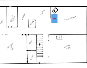

That is good to know. I am leaning toward the family room #2, even though the chimney draft might not be best and I would have the ugly 10" braced chimney up on the roof. I hope the side door would open enough to give me the needed space to load. Its going to be tight, because I have that doorwall along back wall and the hearth will be just a few inches off to the side of where it opens to my back deck. Need to place stove with rear corners 12" from both corner walls.
One of those 55" pre-made corner hearths will just fit. Just.
Is there any possibility with some room reconfiguration of placing the stove on the common wall with the LR? What is above the Family Room at that location?
What stove have you picked out?

Yes, but maybe I would spend more time in living room if stove was located there?
By the layout, it looks like a living room stove would heat primarily the LR and upstairs. If the intent is to heat the house it looks like the family room location is more open which means the stove is going to do a better job of heating where people hang out the most. Some heat will get upstairs, but not all of it. If you are comfortable with the upstairs being a bit cooler (~5º?) for sleeping, then that could work out fine.

No. Again, this would bring the chimney up though the upstairs hallway.

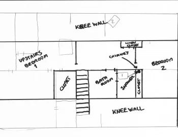

Got it, thx. It's hard to visualize without the second floor plan.

Roof is a 10/12 pitch so I figure at least 10'? Not happy about that. Ugly. So if you were me, and it was your house, would you go with #1 or #2. I am sensing some flip flopping here. Same as me.
I'm a process thinker and like to cover all options, including some not deemed possible before committing. In our house I took out our fireplace and reversed the layout of our living room. The work was enough that I thought about it for several years before executing the plan. At first my wife resisted, but the final result is such a nice improvement that it's now hard to think of it any other way.
For example, if the upstairs hallway was wide enough I would consider boxing in the chimney and adding a linen closet alongside to make it intentional looking. You've had a lot of time to think about this and have a much better advantage in being able to see the rooms and align the 2nd floor layout. So if you think it's going to hurt your eyes, you are probably right. I removed a second stove in our entry area because I didn't like a prominent 8' pipe on the roof at the entrance.
I would take pictures of some of the options, print them or bring them into Photoshop (or similar program) and insert the new look. See how it feels to you. If the roof view of the family room is visually dominant on the house, a 10ft stack will be prominent, especially with a couple braces needed. Here's how the stack looked on our house and how it looks now after the remodel.
Upstairs. Its close to scale, but my original downstairs drawing living room stove would be moved to right so chimney comes though closet. Kneewall area could be used for chimney, as is my family room #2 stove position would use.
  • [Hearth.com] Stove location. Living room or family room.

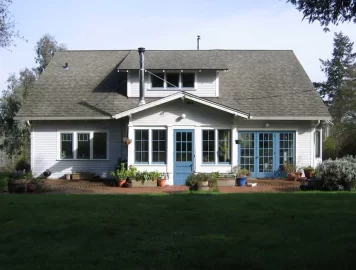

Ten foot chimney would come out roof about four feet to the right of the doorwall. Would not be a good thing, but only other option is stove in living room.
The other option I had ruled out because I read about outside chimney draft issues, is to put stove along right side wall of family room (#3) and have chimney go out wall with all outside chimney. Maybe I should consider this?
Whee, that looks like fun. Well the stack would be less visually dominant than that yellow wiggly guy and in the back yard. But it sounds like you are set on the LR. If so, it will probably need a fan to assist circulation to the main part of the house, but that can be done.
I like this option, a good class A at the proper height will draft just fine even if it's outside. It would follow the house up and be less of an eye sore.

Sounds like that may be the new plan then. I read that it would not draft properly. I am leaning #3

We are cross-posting. With a straight up pipe, I don't think you would have a drafting issue with the stove at location #2. Yes, an outside pipe can work too, especially with the extra height it would require to clear the roof sufficiently. So #3 could work.

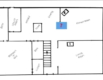

More process thinking here. I'm wondering if location 2 could be moved into the room more so that maybe the existing linen closet could be extended to include a pipe chase?
Your first suggested possible stove location would not be good because of the location of the kitchen table in the dinette area. The second position may line up with the linen closes above, but having half the back of the stove out in the open would not be pleasing (to me) and the chimney would still be about nine feet from the roofs peak, so I would still need about a nine foot tall chimney with braces up on the roof.
