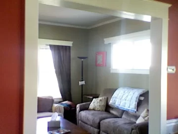

I hope you got a great off season deal on that stove. Napoleon makes a decent wood burning stove. You should get a lot of years out of it. Show us some photos of inside/outside where it is going to be installed, maybe you can get some pre install advice
Here is a picture of where i am going to be installing the stove. This forum is a great place and im looking forward to keeping you guys up to speed on the install and receiving some advice. i don't think i got that good of a deal. i paid $1200 for the stove, door, legs, and air circulator.
The stove will be going were the tall lamp is.

Congratulations. Good choice. It should fit in nicely. That isn't a bad price and you will get a tax credit.
