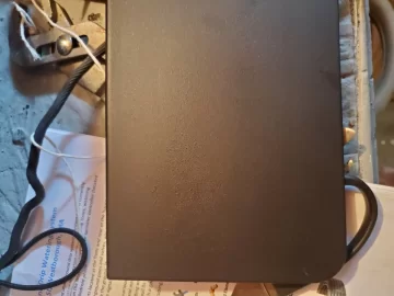

I was recently asking about stove paints and went ahead and got the OEM metallic black for my Osburn 1600 online. Today I decided to test it out on the ash lip and now I'm terrified. I washed it thoroughly, sanded the damaged spots well with 0000 steel wool, wiped it clean of debris with air and microfiber and gave it a coat. Much to my dismay this is what happened almost immediately:
[Hearth.com] Stove Paint Help...What Happened Here?[Hearth.com] Stove Paint Help...What Happened Here?
It looks great....except for every spot I sanded. It looks like the paint is eating away at the original paint? These extremely rough looking spots are just damaged paint now.
So of course I'm terrified to use the paint on the actual stove now. I'm trying to touch up these spots:

That is similar to what happened to me years ago and why I suggested a test in a discrete area first. What paint did you buy?
Yeah thats why I did it on the ash lip as that's easily replaceable. Unfortunately being an insert there isn't a very good test spot.
I used this. According to SBI this was the correct paint:
It's slightly better as it dries but it's still chit. I kind of feel that if I sand the damaged part and try again the same thing is gonna happen. Not sure what to do other than call SBI and ask wtf.

I've been re-sanding as we've been chatting (paint is very fast drying) and gotten back to here. It's obvious the new paint stripped the old paint as the initial damaged spots were only the size of a quarter. I'll call SBI again and see what they say.
