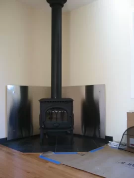

I'm hoping my non-combustible stainless was provides this same convection effect for circulating the heat in the room
  • [Hearth.com] Stove Parts In A Heartbeat
I still think the heat from that stainless setup is going to be awesome.
It should to at least some degree, that is what the 1" spacing requirement is for after all... However I would expect a heat shield next to the stove itself to give more flow simply because it would be pumping more heat into the space, thus driving more of a convection current. Of course if you really seriously want heat, you put a fan so that it blows air through the shield gap. This would give you a much greater volume of air, although theory suggests the air would be cooler.

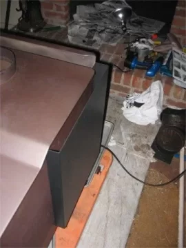

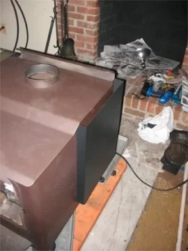

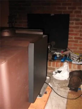

It is going to be interesting. I ran the blower yesterday and the air coming up and straight across the top of the stove from the rear shield fans out immediately and blows over the top openings in the shields. So their is going to be some syphon action across the tops of the shields with the blower going in addition to convection.
Stay tuned. Film at eleven.
