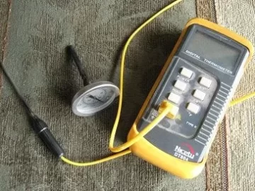

Is it fine to run a probe on single wall pipe?
My dad had a magnetic spring temp gauge stuck on his stove pipe, the stove was very hot and the gauge was reading 0 degrees F. I got rid of it.
In my stove and in my dad's stove I use a barbecue grill lid temp gauge, but some don't go very high. I also use a probe temp gauge to verify the barbecue gauges are accurate, some can be off by 100 degrees F or more. Average cost for a barbecue grill gauge is $20.
You can, but the burn zone recommendations printed on it will not be correct. I've tested a probe on single wall just for fun, and the proper condar magnetic reads just as quickly to changing temps as the probe does.
On single wall, the magnetic is the way to go as a mechanical probe provides no advantage.
Reactions: Squisher
I know that at 900* my magnetic thermo started sliding down the pipe & it will do it every time on single wall pipe. I use probes on my double wall pipe in the house & a cat probe also. I just like to know whats really going on.
I am sorry, there is no way a barbecue probe is slower or the same as a magnetic temp gauge. Convection... hot air (smoke) rising to fast will not contact (exchange heat) nearly as fast. Based on thermodynamics the temperature of the "fluid" will always be higher than the temperature of the outside surface of a "pipe". Plain and simple. Burn zone... :mad: look at the actual temperature and keep it above or below what your owners manual says.
Isn't 900 on a magnetic thermometer dipping into the dangerous zone? And I'll assume that when you were hitting 900 with a magnet thermometer it wasn't on double wall pipe. I like to know what's going on too which is why I have stovetop and two stovepipe thermometers(magnetic condar and washer thermocouple auberins unit). I will say for me so far all of my thermometers seem to be quite accurate and never contradict each other.
You are assuming the conduction of heat through the probe will be faster to make its bimetallic strip change than what a surface gauge can do.
I've used bbq gauges on bbq's and condar probes on stove pipes for years. Unless that bbq's probe goes to over 1k Fahrenheit, it's way too low for the actual temps in there.
A bunch of us did a lot of testing with probes, single wall pipe, etc, 5-6 years ago. Here's a link to see some of what we did back then https://www.hearth.com/talk/threads/3-39-condar-probe-vs-3-19-condar-probe-test-results.63980/
I am going to go and read the link you provided but I am going to ask, at what temp does your surface gauge go up to? Also, if your chimney/flue temps are over 600 degrees F, you have a bad stove.
I am using and had experience only using on a single wall - black stove pipe.
