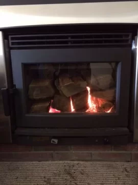

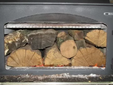

Here's what mine looks like tonight. 18 degrees outside and dropping. 84 inside:)
[Hearth.com] Stove loading pics?
Thanks Lopi! I guess I should take face value of "loaded to the brim". I've never loaded up that much wood in the stove, a bit hesitant I guess of not having control. 800F on the stovetop! That's a lively one;ex
How long until you reloaded that beast?
After reviewing Lopiliberty's post I run my Napoleon in the same exact method. Loading method and temperatures to a "T".
It actually came down to 700 then shot back up to 800 with the air all the way closed. It dropped down to 8 degrees last night. Reloaded this morning at 9am with a stove top of 300 blower still on low and a living room temperature of 78
If its a new stove load it up when you know you are going to be home so you can watch it and know how it will react to full loads. Do this a couple of times and I think you will be a lot more comfortable with loading the stove full

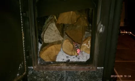

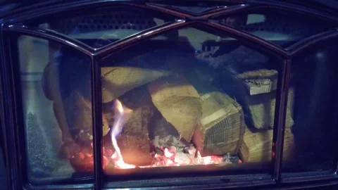

8 splits that would probably require two loads if done sideways. The coal bed was really deep or I could have packed two more of that size.
So, literally up to the baffles. I definitely need to put more wood in the stove. Home tonight so I can experiment and keep an eye on it. I've been putting on average 4 medium splits and getting about 4 hours give or take. The f400 firebox isn't as big as the ones in these pics but I could easily fit 2 more and probably stretch it to 5.5 or 6.
ETA: since the f400's firebox is relatively shallow, any problems with cutting my splits shorter so I can get a N/S load instead of E/W. One of the things that has held me back from really packing it is my concern that once things shift that something will fall forward and hit the glass.

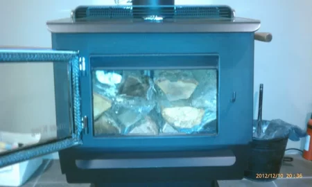

I loaded E/W forever until getting this new stove. After trying it both ways, I will go with N/S (straight in). I can pack it tight with wood, never worry about stuff falling into the door, and I think I get more wood in. Packed as shown in that photo, and damped down to 10-20% air intake, it'll burn at least 8 hours and have a solid bed of coals.

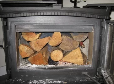

Here's the Shenandoah loaded for the overnight last winter
All I can add is to learn the wood you have and load accordingly and not what others do. I can cram a load of hardwood is a 300 degree stove and be good for the night. If I tried that with some of my hodgepodge I'd have a glowing stove. Start small and work your way up keeping track of coals and temp when you reload. I also have some marginal moisture wood laying around that if I'm at coaling but still hot I know I can load and be alright to load up for the night.

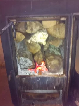

Morning load. The stove is loosely loaded for good air circulation around the splits. That helps it heat up faster.

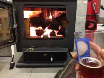

8 splits one e/w in the back, still cant keep my leaky house warm in this cold spell

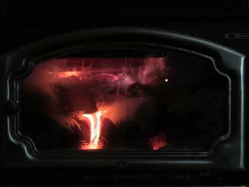

Cut your wood smaller. Ha Ha! I started cutting mine shorter due to muscle atrophy as I age ha ha . Splitting by hand and lifting big logs takes a toll, so I saw more rather than lift more.
I'm going to take your advice. I have the NEO as well and although it is an E/W stove i find it burns way better loaded N/S.
I live with 'people' who are compass challenged :-) . N/S in my mind is feeding wood straight into the box so the length is front to back. E/W is sideways or rolling it in.
