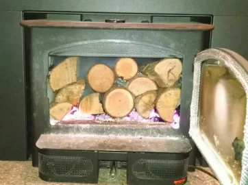

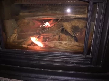

Here's mine. Going from a cold start so the big pieces are N/S. The little pieces on the top go E/W. With a reload I might reverse that. The EW along with the pile on kindling on the front bottom help to spread the fire left to right. Without that the primary air wants to drill a hole through the bottom middle log. Also helps the get the secondaries going.

Light with a fire starter cube on the top and the bottom.

After 1/2 hour I had the air shut down all the way and the IR gun pointed at the flue collar was 650. This should give a nice long burn.

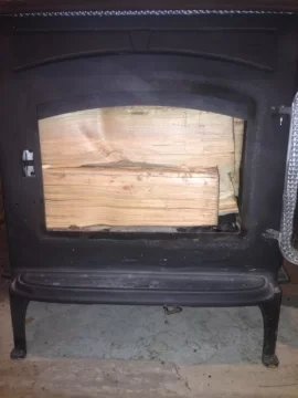

Well here is mine ...
[Hearth.com] Stove loading pics?
The E/W load doesn't look as impressive as a N/S, but I actually have 12 medium sized 18" long splits of fir in my 3 cu ft firebox! Best I could do N/S would be about 8 or 9. Stovetop should be cruising at 600 in no time :)

Looks like you aren't really concerned about the wood settling and touching the glass. Do you not worry about that?
Reactions: iluvjazznjava
i'm a rookie at this, but a split weighs, what, 6lbs? if it rolls into the window, it might have 2lbs of horizontal load. if the glass was this fragile, there'd be a million issues with glass doors.
Interesting take on that and good point.
I stack my loads so the wood angles away from the front . . . but as mentioned, these are neoceramic or pyroceramic and are quite tough . . . the occasional split or round that rolls up against the glass and burns away will usually not harm it (as I have seen happen many a time in my Oslo). The worse thing when this happens is that it often interferes with the air wash and you may get some bad sooting where the wood rests against the ceramic. Seems like most folks who have broken "glass" are just what was mentioned earlier -- someone pushing or slamming their door too hard and the wood strikes the ceramic. I suppose it is possible that a really heavy round or split could roll just right (or wrong depending on how you view it) and break the ceramic . . . but I would wager it's a very rare event.
Nope - not worried. I've had splits roll against the glass many times. As others have said, the glass is quite tough and if it were fragile we would all be buying stoves without windows.

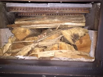

I cut a bunch of my wood at 12-13" so I can load it NS in my insert and pack it full. The wood takes off better that way and it won't roll into the glass. With longer pieces, I still try to pack it full, but sometimes it will take longer to get rolling. I try to fit longer pieces so they won't fall against the door, but if they do it's not the end of the world.
