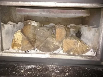

I'm new to using a Wood Stove insert I got with the house. I've been using it but would like some experienced opinions on the loading. Been having trouble finding answers on the site, lot of information to dig through on here but it seems great so far.
Do I load past the height of the firebrick?
Can I safely butt up against the metal tray in there? What is that metal tray for? just to keep from blocking the exhaust out of the box?
Is it safe to allow some wood to sit on top of the firebrick on the sides?
Can I put wood in front of that metal tray if I stack the wood past the firebricks towards the front of the box?
It's an Alaska Kodiak. The manual isn't clear about how much to load the box with.

That metal tray is your baffle, generally speaking most manufactures don't recommend loading above the fire bricks

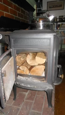

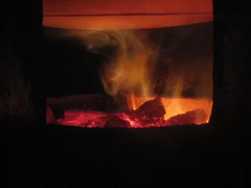

Loaded the Oslo last night at 10pm with plenty of coals for reload at 7:30 this morning and a room temp of 65, cold and windy outside.
20" logs are a good length for the Oslo, easy enough to handle stack and load and if placed right can't fall against the glass.
12 to 14 inch loaded n/s work well too.

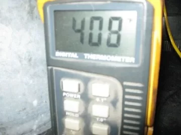

My firebox is fairly deep (3 rows of brick +/- ashes) and if I loaded up as much as what I have seen, I would have my garage door and front door open. I loaded up my stove with some frosty cottonwood & my blower was not turning on. After seeing this post I figured why not load it up! Well, I put a lot of cottonwood bark into it and got a quick response.... It got hot but this is my flue temp.
[Hearth.com] Stove loading pics?[Hearth.com] Stove loading pics?
