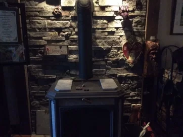

So what would be a good location to install pipe damper on this set up???
Half way up the straight section ?
That should do. Place it where it can be comfortably reached without getting burned.

Just got damper installed and just having it in seems to allow me a little more air control i.e.: not just closed but have it just not quite closed and getting that good slo burn
Just have the damper turned ever so slightly so I think just the little bit of air flow restriction made a difference
Again could have kept it without but probably will be able to have more control
