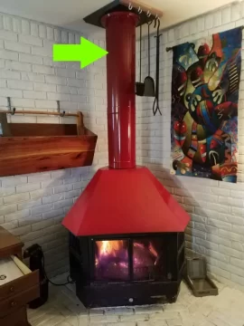

Hi all- first time poster, but I've made great use of the forums while getting to know my wood stove over the past year- so thanks!
My wife noticed that our stovepipe darkens a lot when there's a fire going. It's normally a bright red, but turns a dark shade of burgundy when it gets good and hot.
It's a double-walled pipe. The outside at least is steel, and painted red. I don't own an IR thermometer, but it gets too hot to touch- which I'd assume is to be expected?
It may have always darkened this way and we're just noticing, I can't be sure- the lighting is such that I doubt I'd have noticed it.
Can anyone assure us that this is normal and working as intended, or point us towards a solution if this is, in fact, abnormal?
Thanks!

Might be ok. We have a cranberry red enamel little Jotul that does the same thing. When the stove gets hot the color darkens almost down to wine red. Maybe get a surface stove pipe thermometer and see what the temp reads there.

Thanks. I'd very much like to have a means of checking the temperature. What kind of temperature should one expect to see in a healthy system?
I know that higher temperatures are actually good for preventing buildup & deposits, but is there a limit that you don't want to cross?
I think the photo I included probably makes it look more darkened than it is... The top is more shadowed than the firebox.
Yes, the darkening doesn't look bad, but I don't know much about this fireplace. Contact the dealer and/or the stove mfg and ask if the paint darkening is normal and what expected surface temps would be.

Might be worth going upstairs/into attic etc. to check temps on the nearest combustibles near the pipe as it passes through the ceiling and or roof. I know I did this many times the first year after I installed it. I slept much better after making these checks!
Using a cheapy ryobi non contact temperature sensor mine will get up over 300F while the cat comes up to temp. Once its up and i turn it down it drops below 200 pretty quickly.
I am measuring just 4-5 inches up the dbl wall pipe.
