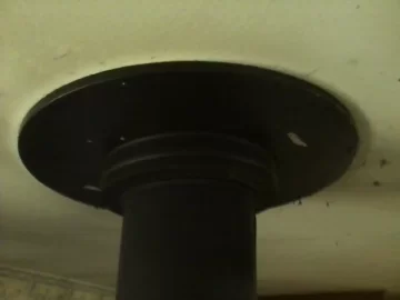

i have a question.i am setting up my new pellet stove and want to use my existing 8 inch stove pipe. the problem being i don't remember what brand it is. the pipe that connects to the ceiling does twist and lock into place would this mean it is a Dura system pipe? and if so do i need to stay with this same type of pipe.
It seems each brand has a different connection system so it is best to stick with the same brand for a better chance at a clean seal. If you are not sure, try taking a photo of it with a cell phone so you can take it to the store with you. How are you planning to configure your pipe? 3" or 4"? Pipe brand will be more important for an adapter...
here is a picture ceiling box. it is a female fitting with an 8 inch pipe that goes in grove and twists to lock
ok so i took a pic of the connection on the ceiling sent it to Duravent support. they got right back to me and said it was their system and suggested which way i should proceed.I would like to thank you for your help and the help of this great web site. Thanks again
Great to hear that you have brand and part sorted out ... Don't be a stranger! Let us know how you make out with install ... you might want to do your cure in burn outside before setting it in place in the house.
