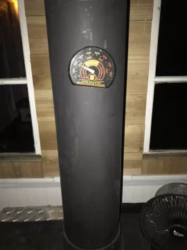

I sorta new to wood stoves I bought one for my man cave but I am confused on temps
When I first got my stove the pipe temp would show a high temp ( but doesn’t that mean I am losing too much heat )
I have a magnetic thermometer I got from Lowes if I put it on the stove top it is in the 400 degrees range if I put it on the single wall pipe it won’t go over 200 mostly at 150
But yet my stove is hot and no smoke out of chimney I do not have a damper either should I have put one
And I can’t remember exactly last year I did not use it much but I seem to remember the pipe temp getting to optimal burn range
Could this mean I have creosote in the pipes
Planned on cleaning pipes this summer
Sorry for so many questions

Your flue temperature reading is meaningless; can't measure it with a magnetic thermometer stuck on the outside of the round pipe.

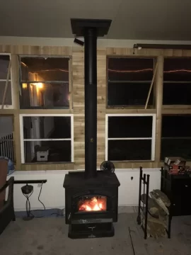

Describe the venting system; pictures would help.

Well, I don't think that's exactly true. With a surface meter about 18" above the flue collar on single-wall pipe, I think the rule of thumb is that it will read about 1/2 what the actual flue gas temp is..
Echoing jetsam again, what is your chimney setup? Is this Class A chimney all the way up or pipe going into a masonry chimney, or what? would get up on the roof and brush out your chimney when you can, just to see what's going on, and make sure you're safe.

Inside flue is a single wall pipe ( from Lowes)
About 6 feet
Exterior double wall about 4 feet ( tractor supply)
It is in an enclosed patio cover is insulated and nearly flat

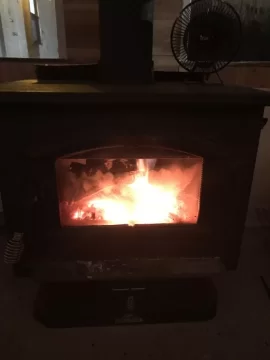

It just seams that I have to fill the box with wood burning like crazy to get it hot enough
( maybe it is just a crappy stove)

Got the flue temp close to optimal ( with magnetic thermometer) very little smoke
I will take a few pictures tonight to show setup

Go up and remove the chimney cap and clean it. That may be the issue. Check the pipe while up there and see how it looks. If it is getting choked up with sote, clean the chimney too.
It sounds like the stove might not have sufficient flue height to achieve good secondary burning, especially in milder temps. You could test this by pulling the chimney cap and sticking a 4' length of 6" warm air pipe into the chimney crimp down. Do this on a calm day. Then see how the stove performs with this temporary extension.

That is not true at all I and many many others use that method to very successfully run their stoves

Should I still need an extension if I am above 2 feet of the highest part within 10 feet
Or are you telling me that it will burn hotter with more pipe ( possibly)
Like tonight I have to cram it with wood looks hot but doesn’t seem to get hot enough

If the stove has insufficient draft then it will not get a good secondary burn. This is where the heat is. This is irrespective of the 10-3-2 rule for chimney height. If the numbers provided are correct (6' stove pipe + 4' chimney) then it's very likely there is insufficient flue to create a good draft, especially in Louisiana temps.

I think I have more pipe in the attic if it ever stops raining this weekend I will give it a try
